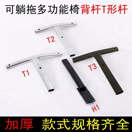

去買一個椅背杆來裝不就好了嗎?
https://item.taobao.com/item.htm?sp...bucket=8#detail
