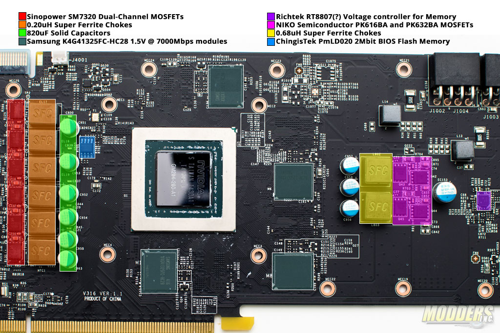

無意中看到的 現在被MSI管理員鎖定 為了怕毀屍滅跡幫忙轉一下 原汁原味各位自行斟酌
果然顯示卡一個不公版大家就開始偷偷偷 台灣廠商的嘴臉
[YOUTUBE]_E3Mc0oDvFQ[/YOUTUBE]
6 phases = OnSemi NCP81174 = Fake
Got a reply from MSI:
My query:
'Hi, I'm interested in buying one of these cards, but I have a concern that may put me off. Your specification says the card has 6 power phases for core Voltage. However the Buck-controller on the card (OnSemi NCP81174) is for of 4 phases max. Have you connected the phases in 3-phase logic, or am I missing something here? Hope you can shed light on this subject. I'm not the only one wondering =)
Best Regards
Olli Turunen'
Reply:
"Dear sir/madam
Thanks for contacting MSI technical support.
Regarding your concern,Hi,this card has 6 power phases for the core voltage.It is right that the buck-controller for onsemiNCP81174.But i can not to tell you anymore about how to design 6 power phases by this IC. Because it is company secrets.
Thanks for your cooperation in advance!
Best Regards,
MSI Technical Support Team"
Worst power supply system of all GTX 970 cards! 3 + 2 phases! :biggthumbsdown:

well...要貼也貼完整嘛
下面也有人提出相反意見,不過俺看不懂,求高手解釋
Copied=GPU power control is handled by an ON-Semi conductor NCP81174 4-phase controller (located at the back PCB) operating in 3-phase interleaved mode with six dual-channel Sinopower SM7320 doubled with drivers at the back.
Looks like a 6+2 design! Why would you think MSI lie about their products? the only thing I want a answer about is the fan problem.

重點是 "Buck-controller on the card (OnSemi NCP81174)"
實話說目前看的到有拆風扇的測試中 比較屬意ASUS layout明顯較好
Gainward也不錯但是不好買 MSI Giga EVGA喔 呵呵
公版卡還是有存在的必要性 一自己弄就花樣多起來 好好老實做產品不好嗎

說真的如果是只控制3phase(因為controller只能控4phase), 但是官網把6phase當成賣點, 這就蠻糟糕的.
multi-phase的重頭戲就是重載時的 ripple current可以抑制的非常好,
6變三然後每一個phase的電流兩倍(因為是兩組buck), 這會搞到ripple current過大.
只能說真的還蠻糟的, 如果屬實.

l兄轉貼這篇老歪的疑問的確很有趣,儘管微星官網沒有寫出6相供電,但多數review都有所提到。
引起我注意的是,如果這張卡是真3相並聯假6相供電,為什麼3D Mark Fire Strike的970單卡排行榜上前N百名通通都是雞排與小星星?其他牌子的OC性能完全被甩開兩條街?微星RD真的有秘密武器?這確實引起我的好奇。
作為第一步,我去找雞排的Review來看(我對這家非常感冒,所以買之前從來不關心 )
發現雞排的GTX970也是6相供電卻使用NCP81174(4-phase controller)
這下可有意思了,兩個被指責疑似供電相數廣 告不實(呃...好像官網上並沒有標註)的產品能力壓群雄,使用IRF ASP1212 8相controller、在官網上標註"DIGI+ VRM with 6-phase Super Alloy Power"的ASUS貓頭鷹卡卻在超頻極限上被甩開兩條街?
衝著微星賣關子的「But i can not to tell you anymore about how to design 6 power phases by this IC. Because it is company secrets.」
作為一個技術門外漢愛好者,我實在很想知道真相,因此曠了半天班找評測一探究竟
發現不但GTX970,就連GTX980兩家(雞排/星星)也是使用ON-Semi NCP81174作為主控供電迴路設計,我說用四相並聯去扛TGP 366W的卡會不會太屌 ?
顯然不是,經過一些交叉閱讀,modders-inc的Review以及電腦王qhua大大告訴我們這是由phase doubler所達成的,例如雞排GTX980採用的是 4 顆 NCP81162,將原先 4 相擴展為 8 相,再接著由 8 顆 MOSFET Driver 控制 8 相迴路。而星星的GTX980也是採ON-Semi 81174 這款 4 相控制器由 4 顆 Doubler 與 4 顆 MOSFET Driver 組合而成
至此應該真相大白了:不是集成度高的controller其上限就是迴路相數設計的天花板,依然有方法可以利用phase doubler達成目標的。
不過,這還不足以解釋EVGA(4相,直接用NCP81174)和ASUS(6相,ASP1212)極限超頻能力明顯輸條街的理由,特別是後者。
餵狗再找了圈
原來各家BIOS用KeplerBiosTweaker解開一看,
雞排的TGP MAX設在280W,星星設在220W,石頭196W,EVGA竟只剩187W!
根據 GPU Boost 2.0 的架構,頂到任何一項Limit,動態時脈就會降下來
撇開其他限制(Voltage、Temp、Rail Limit),這麼一看,光TGP設定就顯示出廠商對電路的自信與最高運行時脈結果差異,是不是相對於3D MARK排行榜也十分合理呢?

這就更神了, 假6贏真6!
