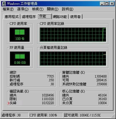

You need to find out your maximum memory usage 尖峰.
If 尖峰> RAM, don’t bother with ramdisk Pagefile. [ you need more RAM]
