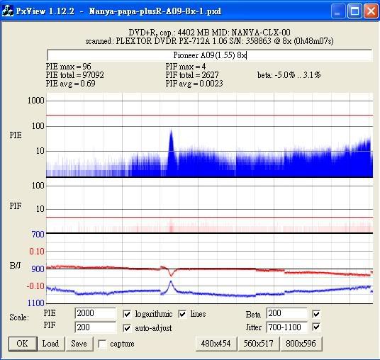

Pioneer A09(1.55) 8x
DVD測試:http://tw.myblog.yahoo.com/jw!UDBG1IWLBUcpTbQIT.Y-/archive?l=a
DVD燒錄機: A08, A09, A10, 111D, 3500A, 3570A, 5170A, 712A, 716A, DW1640, LG H22N
數位電視機上盒比較表 http://tw.myblog.yahoo.com/jw!UDBG1IWLBUcpTbQIT.Y-/article?mid=467

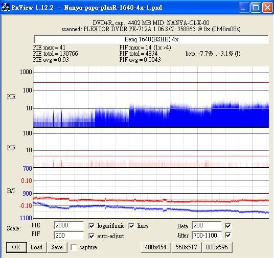

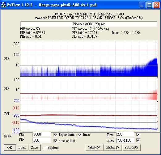

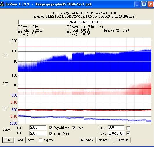

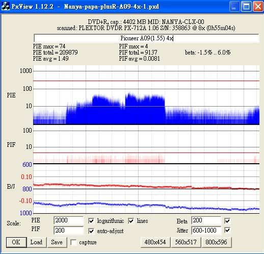

Plextor 716A(1.08) 4x
Benq 1640(BSHB) 4x
Pioneer A08(1.20) 4x
Pioneer A09(1.55) 4x
