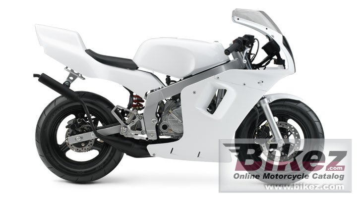

HONDA NSR50R最大馬力7.2hp/10000RPM
http://www.motorcycle-usa.com/115/3...R---NSR50R.aspx
