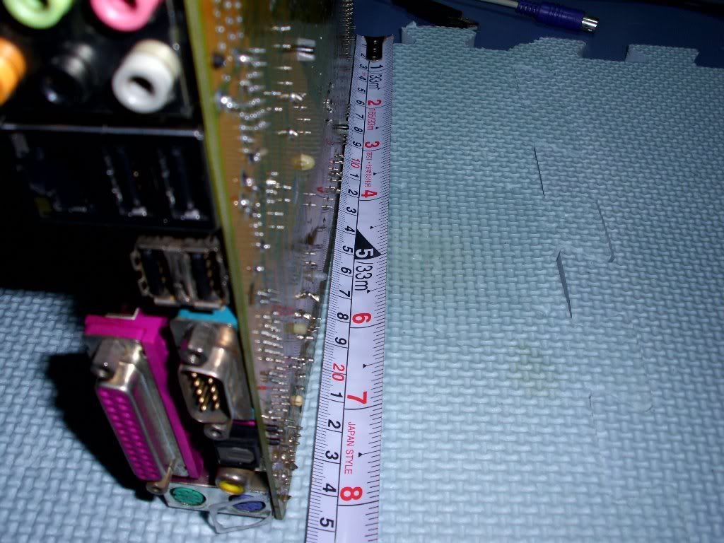

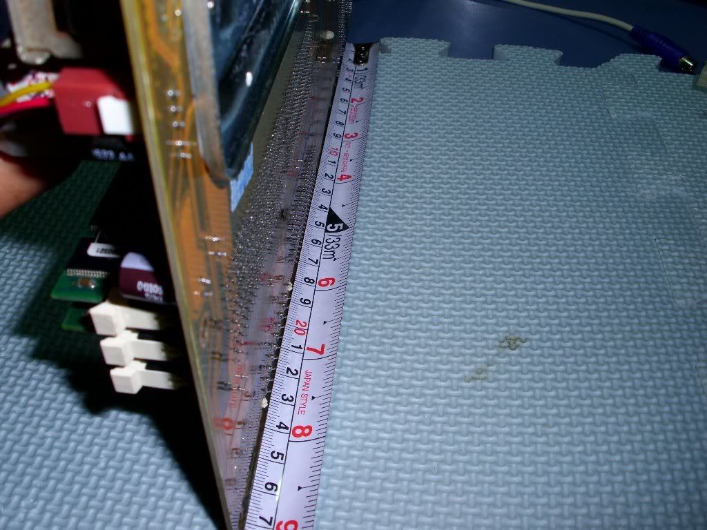

因為原廠的扣具不是都只有4個點固定而已嗎?請問下壓力是什麼意思?
我的也是改212灣版了,用束帶直接往上抬,但是稍微動上面的風扇到會當機或重開機XDD
請參考一下I社的design guide,第38頁是這麼寫的....
2. This is the minimum and maximum static force that can be applied by the heatsink and it’s retention solution to maintain the heatsink to IHS interface. This does not imply the Intel reference TIM is validated to these limits.
4. This minimum limit defines the static compressive force required to electrically seat the processor onto the socket contacts. The minimum load is a beginning of life load.
問題是要散熱器提供下壓力,卻又只靠4個pin固定在MB上,久而久之當板子彈性疲乏時大概就只能靠老天保佑了:ase:ase....

小弟之前處理的板子,有強化背板彎板情況輕微許多,
如果彎板過於嚴重可能造成脫焊,因此情況許可最好還是自力救濟一下,
intel原廠扇扣具小弟從數年前撻伐至今,還是沒啥改善,
也許是廠商間不能說的秘密~~
asus p5ld2無強化背板
asus k8n有強化背板
