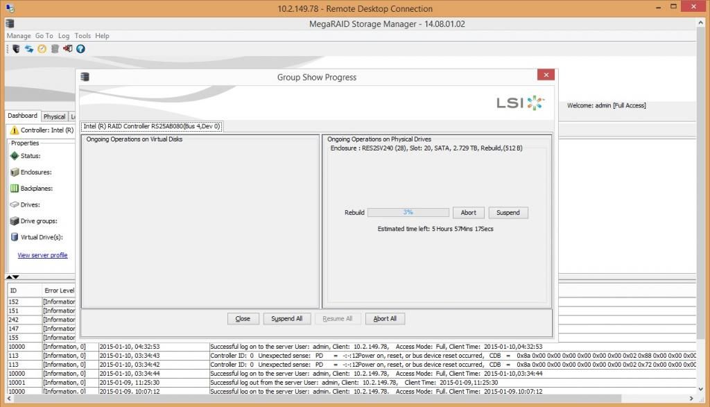

vxr 2015-01-10 04:41 AM
該來的終於還是來了...:laugh:...
chaotommy 2015-01-10 12:51 PM
:jolin: :jolin: :jolin:
vxr 2015-01-10 02:40 PM
又雖洨了...
超級電容宣告不治....:laugh:....
vxr 2015-01-10 07:32 PM
沒辦法...
只好去買一顆電容回來...:flash:..
